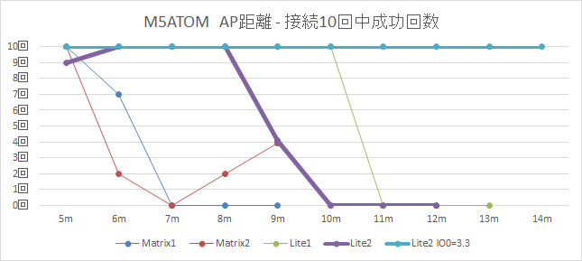

      In my evaluation, the effective range from Wifi AP was short:
       Matrix(n=2) - 5m
       Lite(n=2) - 8m, 10m

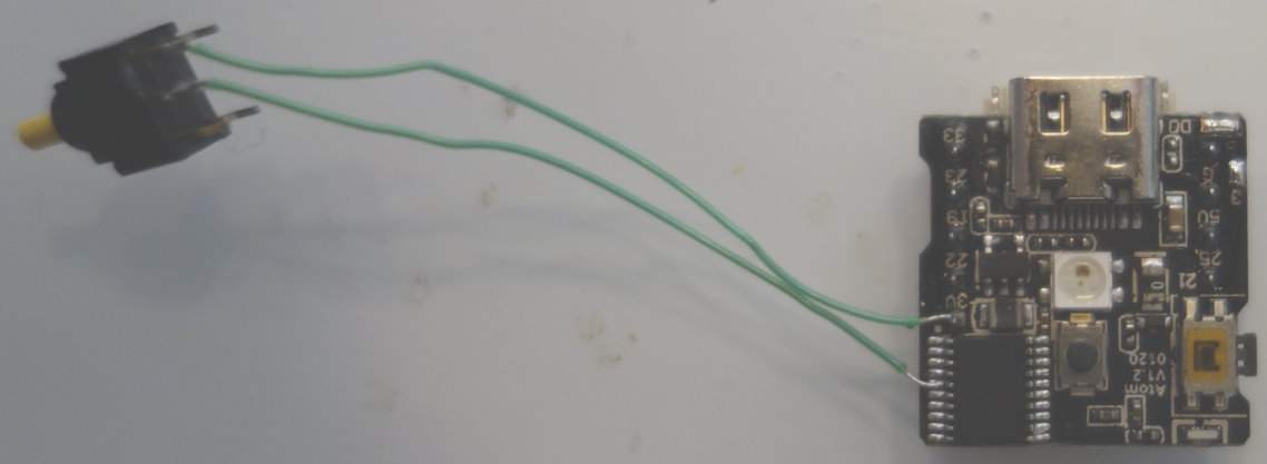

      Just an experiment (NOT solution), I connected IO0 to 3.3V of Lite, then the effective range was expand from 8m(purple) to over 14m(light blue) (n=1).
      I wish the improvement by CH552 VCC 5V->3.3V on next board rev of ATOM lite and matrix.
