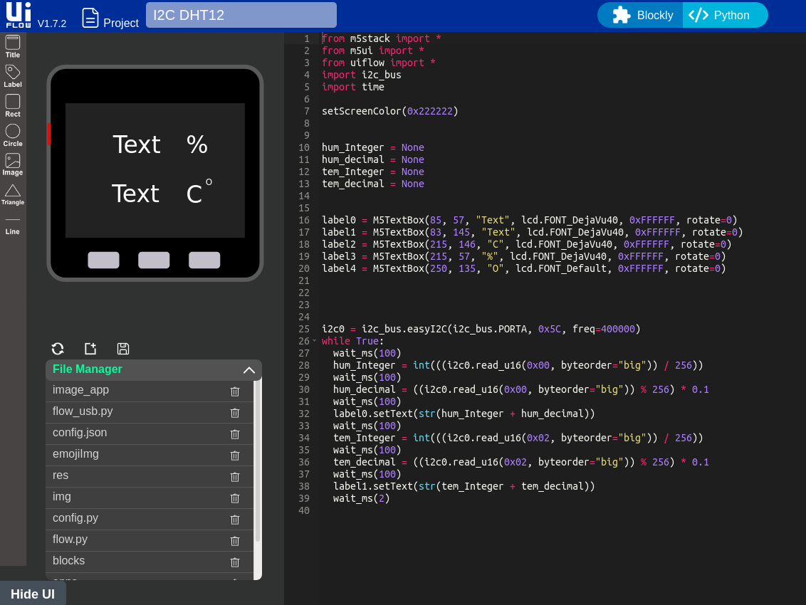

      unexpected keyword argument freq
      M5stack CORE
      UI 1,4,5
      from m5stack import *
      from m5ui import *
      from uiflow import *
      import i2c_bus
      setScreenColor(0x222222)
      label0 = M5TextBox(85, 57, "Text", lcd.FONT_DejaVu40,0xFFFFFF, rotate=0)
      label1 = M5TextBox(83, 145, "Text", lcd.FONT_DejaVu40,0xFFFFFF, rotate=0)
      label2 = M5TextBox(215, 146, "C", lcd.FONT_DejaVu40,0xFFFFFF, rotate=0)
      label3 = M5TextBox(215, 57, "%", lcd.FONT_DejaVu40,0xFFFFFF, rotate=0)
      label4 = M5TextBox(250, 135, "O", lcd.FONT_Default,0xFFFFFF, rotate=0)
      hum_Integer = None
      hum_decimal = None
      tem_Integer = None
      tem_decimal = None
      i2c0 = i2c_bus.easyI2C(i2c_bus.PORTA, 0x5C)
      while True:
      wait_ms(100)
      hum_Integer = int(((i2c0.read_u16(0x00, byteorder="big")) / 256))
      wait_ms(100)
      hum_decimal = ((i2c0.read_u16(0x00, byteorder="big")) % 256) * 0.1
      wait_ms(100)
      label0.setText(str(hum_Integer + hum_decimal))
      wait_ms(100)
      tem_Integer = int(((i2c0.read_u16(0x02, byteorder="big")) / 256))
      wait_ms(100)
      tem_decimal = ((i2c0.read_u16(0x02, byteorder="big")) % 256) * 0.1
      wait_ms(100)
      label1.setText(str(tem_Integer + tem_decimal))
      wait_ms(2)
      I2c Bus error 6

        Have you considered using the latest UI 1.7.2? Your code runs fine here on a M5Stack Gray and UI 1.7.2.
