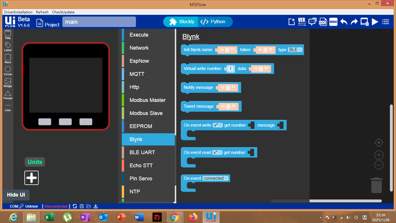

      There is the thing I only could active either USB or Wifi mode on M5stack. How do i make use of the block inside Uiflow?0_1611925986526_屏幕截图(260).png

        Just program it with WiFi or USB and then set up the BLE connection within the Blynk app (via the BLE widget). The configuration (hardware device to app) for Blynk within uiFlow is only BLE (i.e. no option for WiFi), so it's not relevant for the actual programming of your M5Stack Fire via WiFi or USB.
