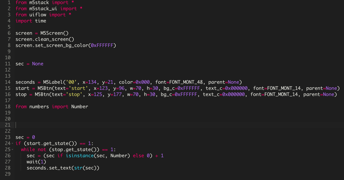

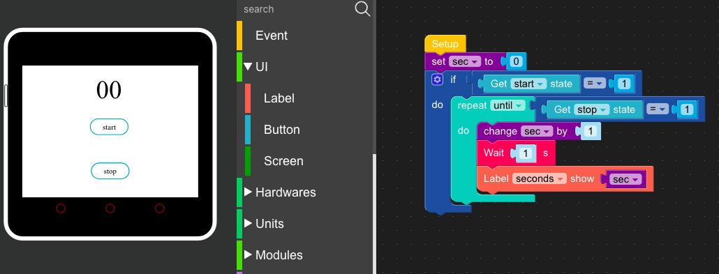

      Hello, I am trying to create a stopwatch but cannot figure out why it doesn't work. Here are some pictures: 0_1610730824290_Skärmavbild 2021-01-15 kl. 18.12.05.png 0_1610730830305_Skärmavbild 2021-01-15 kl. 18.11.45.png

        you are very close. Right now your code only executes once after loading and running it onto your M5Core2. Try putting all your existing code into a loop statement. (You'll find the loop statement in the Event section.)
        Cheers
        Felix

            @felmue Thanks, that fixed it
