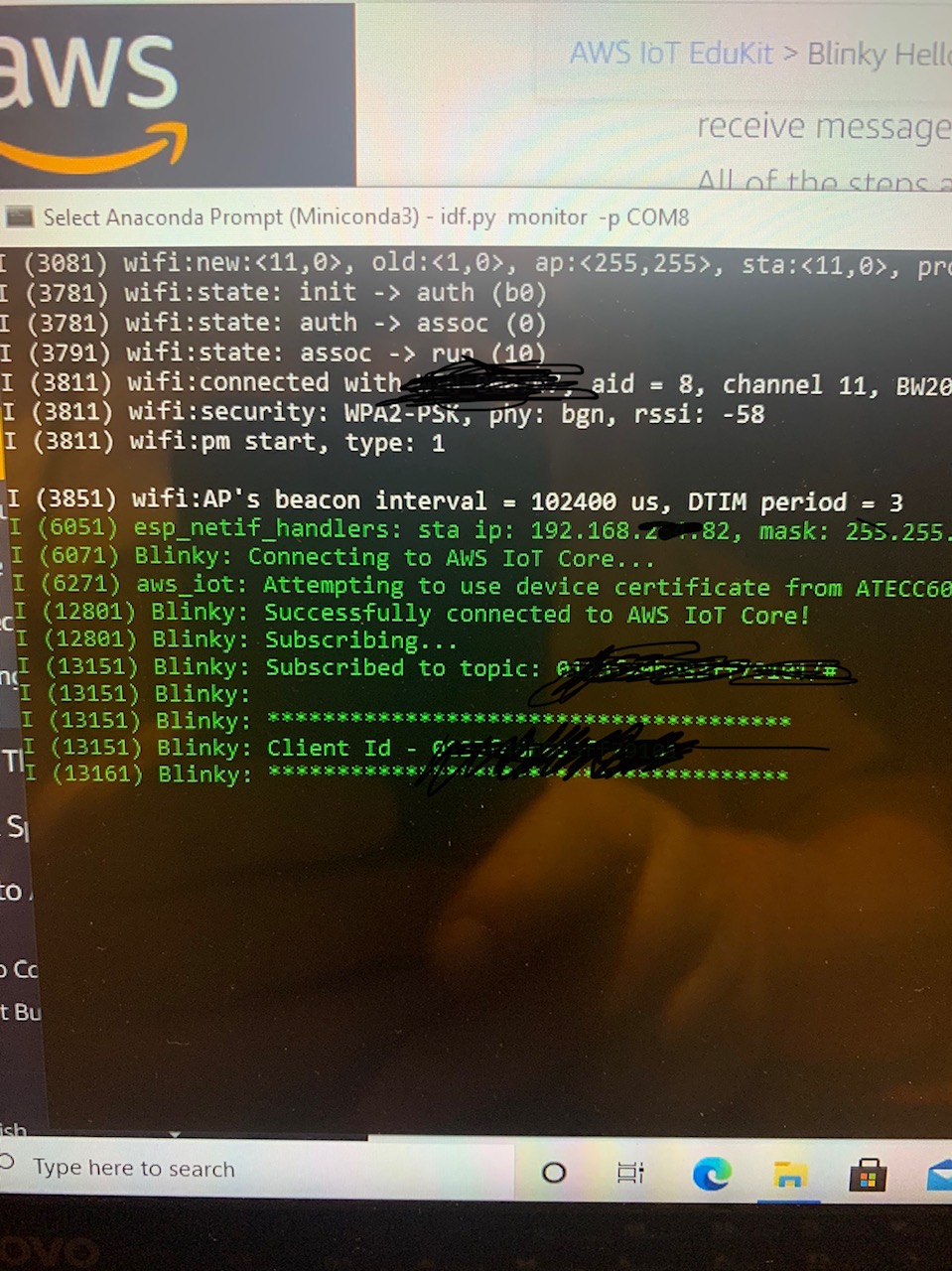

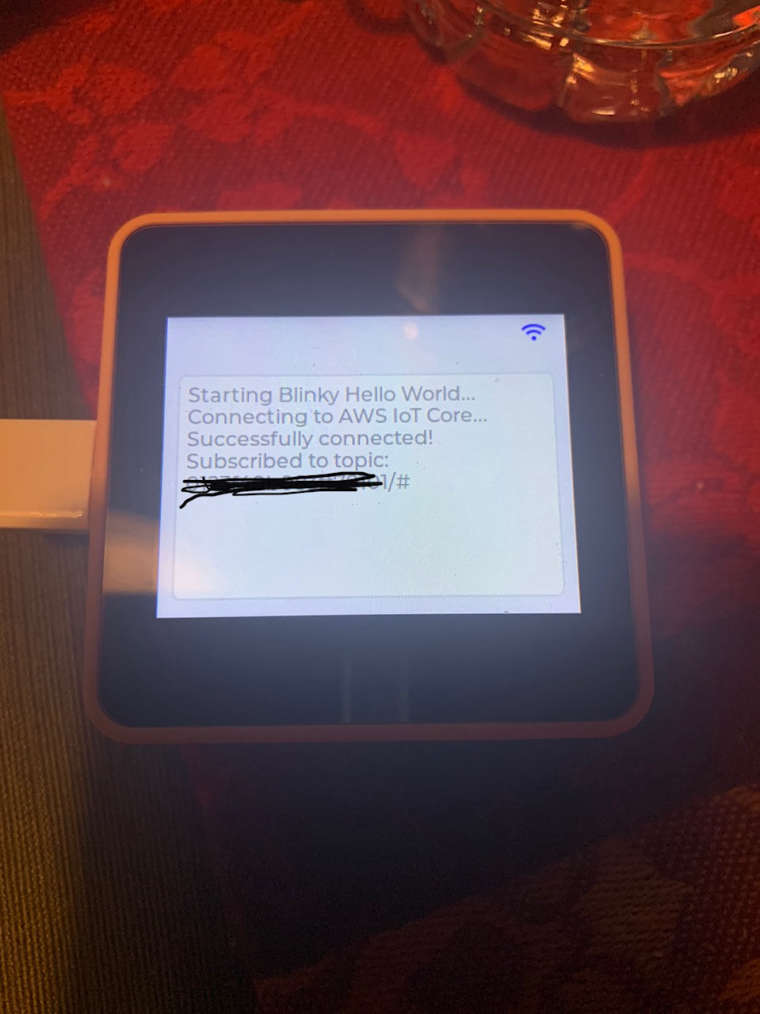

              • K Offline
                ksprayberry @greenleaf
                @greenleaf The esp-idf is indeed a bear to build. I managed to get it built and work my way through the tutorial. They actually changed the tutorial on me halfway through taking out the bit about the Jupyter notebook and replacing it with a certificate helper. I managed to work my way through it all, compiled the program and have run it, but I cannot get the lights to blink. It has the appearance of being connected, but no blinky blink. Any thoughts as to where I may have went wrong?

                • greenleafG Offline
                  greenleaf @ksprayberry
                  @ksprayberry Make sure you are in the correct AWS region. The test button on the MQTT page won't throw any errors or output if you're not in the correct region.

                  • K Offline
                    ksprayberry
                    ok thanks. i used the "us-west-2". Let me check again.
                    • K Offline
                      @greenleaf Woohooo! That was it! I changed it to the North Virginia and it worked. Of course now after its working, I kind of fee like Ralphy on the Christmas Story after getting his Little Orphan Annie Secret decoder ring...."Be sure to drink your Ovaltine" a crumby commercial? SOB!" No, thank you, I was so close and it was something small.
