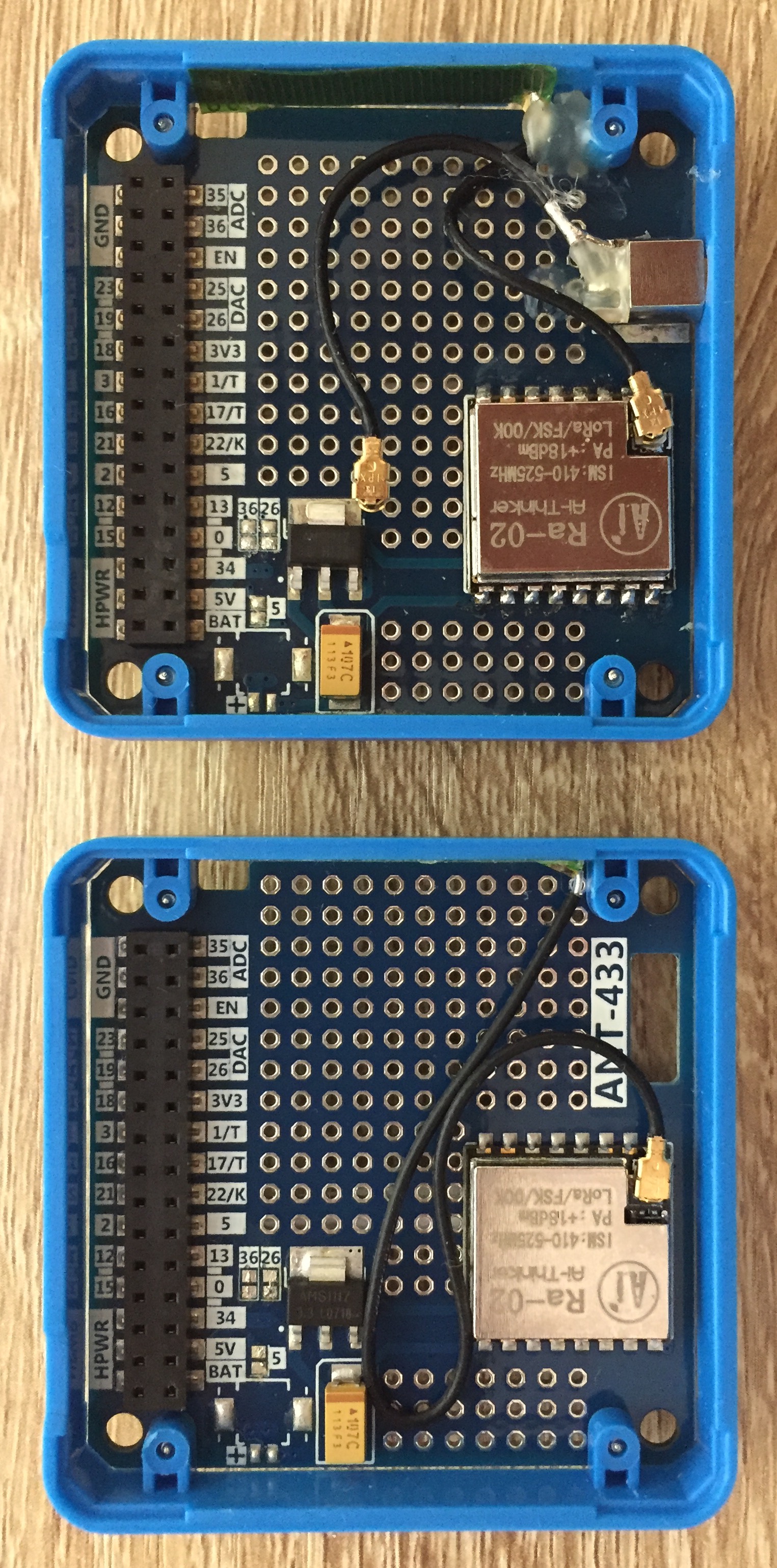

      LoRa
      MOSI	23
      MISO	19
      SCK	18
      CS	 5	(5 )
      RST	26	(26)
      INT	36	(36)
      In the case of the LoRa module, I'm using all the default pins, so there's no need to solder any bridges or scrape any wires. I bought a LoRa board and only then realised that LoRa is more fun if you have two boards (I had two M5Stack main units already). So I bought another one and got a slightly different unit. The picture shows the unit I first got on the bottom, and the second one on top. As you can see the new unit has a connector for an external antenna as well as an internal one. In the picture you see the pigtail for the internal antenna connected, it came with the external antenna jack connected. After taking this picture I taped down the other pigtail with a little square of duck tape so it doesn't touch anything important.
      The M5Stack LoRa uses the RA-02 radio module by AI-Thinker (datasheet) that is itself built around the Semtech SX-1278 transceiver chip (datasheet). If you actually start playing with the LoRa module, you might also want to read this article that GoJimmyPi wrote on it.
      Also note for your information that the following information is in the M5Stack documentation on the website as of Jun 20, 2018:
      This seems to be correcting something that is wrong elsewhere but it is actually wrong itself: RST is GPIO 26 and INT is 36. I measured it on both my boards with a multimeter, RST is really pin 26 and it would have to be because on the ESP32, GPIO 36 is input only so it could never drive the RST pin.
      People that want to save on available GPIO pins could leave off the reset pin. In that case, just pass -1 as the reset pin number, the second argument of LoRa.setPins in the M5LoRa library. If a pin is provided, all the library does is pull it low briefly once when you call LoRa.begin().

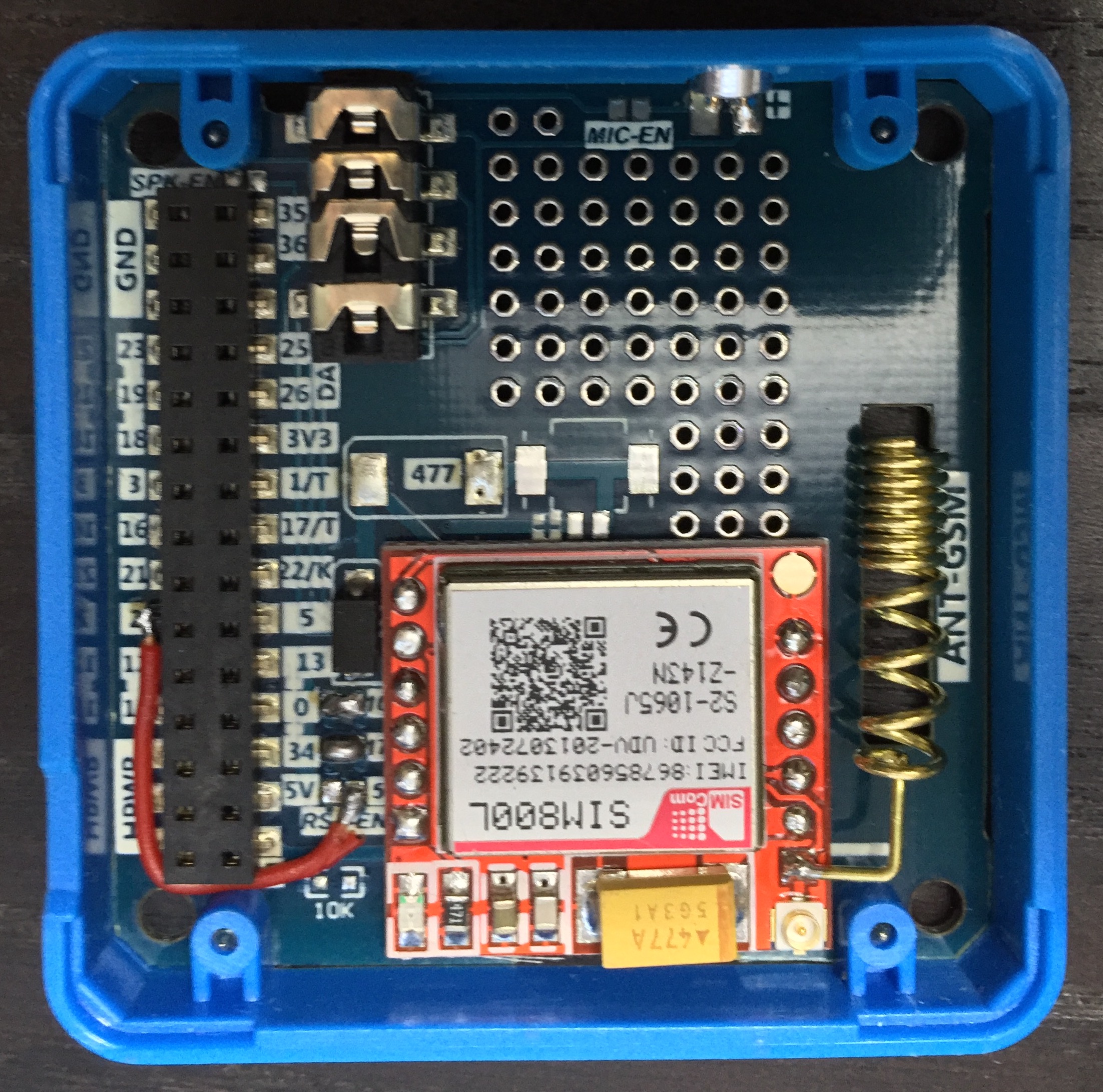

      GSM (SIM800L)
      TXD	16	(16)
      RXD	17	(17)
      RST	 2 (!)	(5)
      Rx and Tx can use the default pins for UART2, but as you can see in the LoRa section above, we have already used the pin used to reset the GSM (GPIO5) as the LoRa ChipSelect pin, so we have to choose something else here. Unfortunately the solder jumpers do not allow for any other choice, so I carefully scratched out the hidden trace between the two pads of the 5 solder bridge and soldered in a little wire from the GSM side of that bridge across to a free pin, choosing GPIO2. Note that you want to unscrew the boards from the plastic frames with a little hex screwdriver before soldering wires in.
      The M5Stack SIM800L GSM board has a SIMCom "Core Board" module on it (the board with the red solder mask) that itself sports a SIM holder and a SIMCom SIM800L module (datasheet). This is a quad band GSM with GPRS, but no EDGE, 3G, LTE or anything else fancy.
      People that want to save on available GPIO pins could again leave off the reset pin: unless your code pulls it low it is not used.
