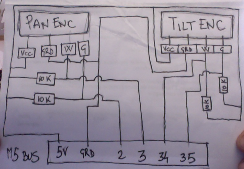

      Hi All, this is my porting of KinoWheels to m5stack using espnow to play wireless with R0nin
      tested with:
      R0nin 1
      KinoWheels
      R0nin Forum
      TX: M5Stack + PROTO MODULE
      RX: M5Atom Lite + GROVE cable
      SOFTWARE:
      first we upload rx code to know the mac address on serial monitor

      open arduino serial monitor and pick the receiver MAC ADDRESS.
      put the receiver MAC ADDRESS, in the TX code instead of "XX"

      uint8_t remoteMac[] = {0xXX, 0xXX, 0xXX, 0xXX, 0xXX, 0xXX};

        // clear the encoder's raw count and set the tracked count to zero
        encoderX.clearCount();
        encoderY.clearCount();
        // Attache pins for use as encoder pins
        encoderX.attachHalfQuad(2, 3);
        encoderY.attachHalfQuad(34, 35);
        Serial.println("<ready>");

      HARDWARE
      encoders wiring on M5Stack is a bit different of original kinowheels (arduino mega) one.
      with esp32 based board you can invert ttl signal in serial.begin declaration... so no need to add a serial inverter IC for D-Bus, so ATOM GROVE cable go straight to R0nin D-Bus
      GROVE ------ D-BUS
      GRD ---------- Black
      5V ------------ Red
      TX ------------ White
      RX ------------- Yellow (not connected on R0nin1) to test on R0nin2

          Do you have a photo of the wiring? I don't understand the wiring diagram well. Thank you.
