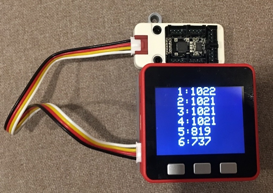

      Today I try to connect OP180 via PbHUB that using CH4 and CH5 but cannot be detected, I tried to erase and re-burn firmware by using M5 Fire it's show CH4 and CH5 read value (disconnected all CH) is not over 1000 .
      I checked with schematics seems CH4 and CH5 input is only Analog.
      Kindly confirm me as well before I send this unit to RMA process.

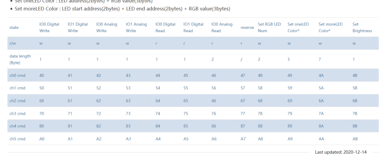

            hazo @felmue
            @felmue Thanks for your reply. I found the table below on the official M5Stack (https://docs.m5stack.com/#/en/unit/pbhub?id=pinmap) and started from there. That's why I thought all ports had the same functionality ....
