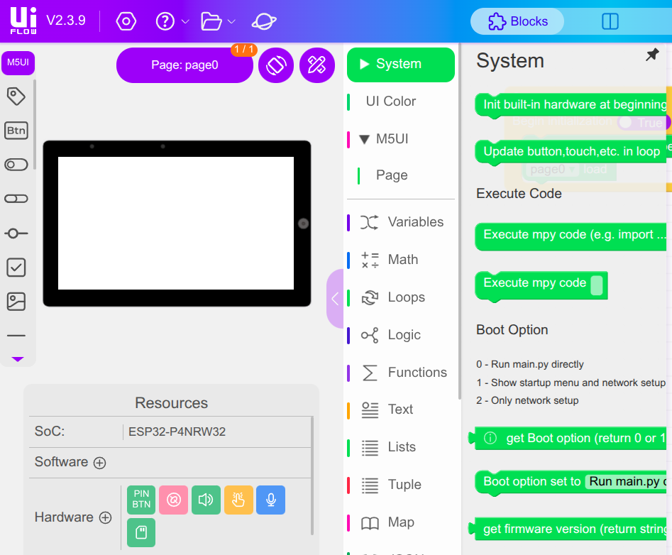

            I am running V2.3.8, and all I see under System is "Execute mpy code (e.g. import)" and "Execute mpy code". I tried putting the block
            Execute mpy code [print("## HELLO ##")]
            in the loop, but it had no effect. In fact, it wasn't translated to python code in the code window.
            Did inserting python code directly get dropped?
            Michael Huster

                I only get
                execute mpy code []
                You can see I reloaded and got V2.3.9. I get the same whether I choose a Tab5 or an Atom Echo. Or M5GFX or M5UI for the Tab5.

                  • ProfHusterP
                    ProfHuster @felmue
                    @felmue,
                    Thanks, that worked. I think what happened is I clicked on the code window and did some editing, then went back to the blockly panel. It seemed when I did that, the blockly no longer updated the actual python code.
                    I will check out your examples,
                    Prof Huster
                    • felmueF
                      felmue @ProfHuster
                      Hello @ProfHuster
                      yes, that is what I observed too. As long as edit mode in Python code window is enabled, changes on the blockly side get ignored. (I guess that's to prevent changes from being overwritten.)
