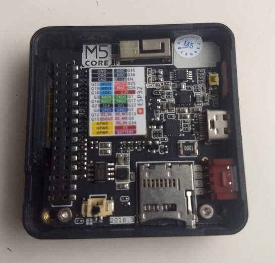

I have few M5stack basic core modules and on a couple of modules I have a crazy behaviour with power management</p>
<p dir="auto">I power M5stack via external battery (3.7v LiPo) so connecting it on the expansion bus via GND and Battery pin (pin 1-3-5 and 30) using a custom made expansion board</p>
<p dir="auto">If I power the core via USB C connectors it powers on regularly and the battery is charged via IP5306 chip<br />
If I disconnect the USB C after the battery is charged the core stay ON and if I press the power button once I can do reset and reboot the core</p>
<p dir="auto">so this gives me the idea that the battery connection via expansion bus is OK (it charges and it provides 3.7v to BAT pin of ip5306)</p>
<p dir="auto"><strong>than if I power off with double click of the power button there is no way to power on again !    It seems like the IP5306 does not weak up and start the circuit</strong></p>
<p dir="auto">Notice that I have same behaviour with the origina bottom that contains the small battery so this exclude a problem with my custom board</p>
<p dir="auto">Than suspecting some issue on my proto board bus connection I have inserted in the middle a original M5 FAN module..that is basically a passive pass trough module with FAN connected to 5V</p>
<p dir="auto">And magically now I can power on and off regularly the core!</p>
<p dir="auto">Just to have a final proof I keep the fan module in the middle and disconnect the fan (so reducing the overall l load) and again if I shut down the core no way to power on again</p>
<p dir="auto">Since all the power management is done by ip5306 chip (no bootloader sw nor application SW is involved) really don't understand what is wrong and why only on few cores are affected</p>
<p dir="auto">Could be a faulty ip5306 ?</p>
<p dir="auto">any suggestion to recover may cores is appreciated</p>
<p dir="auto">Davide</p>

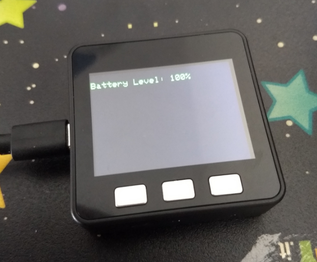

<p dir="auto">The bus scan found the IP5306 at address 0x75<br />
I upload a simple sketch to monito battery level and it works</p>
<p dir="auto"><img src="/assets/uploads/files/1557394847171-16b57fcb-ad0f-435d-9d35-eca3088a4578-image.png" alt="0_1557394841048_16b57fcb-ad0f-435d-9d35-eca3088a4578-image.png" class=" img-fluid img-markdown" /></p>
<p dir="auto">this is good but still don't solve my problem<br />
-if I power m5 core with USB all ok<br />
-if I disconnect USB using core bottom battery the core stays on and I can do reset with power on again<br />
-if I power off (double click) no change to power on again</p>
<p dir="auto">anything now that I can modify in IP5306 register to fix the power on ?</p>

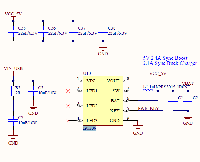

<blockquote>
<p dir="auto">This schematic is wrong, every core is used i2c ip5306.</p>
</blockquote>
<p dir="auto">Really ? I don't know if this is a good or a very bad news...<br />
having IP5306 with I2C and enable SW control of power management is nice but knowing that the official schematic where I have based the design of my custom HW and development of SW is not the real one really puzzle me !</p>
<p dir="auto">this is the official schema on github<br />
<a href="https://github.com/m5stack/M5-Schematic/blob/master/Core/Basic/M5-Core-Schematic(20171206).pdf" target="_blank" rel="noopener noreferrer nofollow ugc">https://github.com/m5stack/M5-Schematic/blob/master/Core/Basic/M5-Core-Schematic(20171206).pdf</a></p>
<p dir="auto">Is there an updated one ? are there other differences ??</p>
<p dir="auto">I know that M5Stack is not "open source" but without a real schema quite difficult to mange any HW/FW development</p>

My M5stack BASIC core comes with IP5306 that has no I2C interface to ESP32 (should be very very useful to have and move power management to SW level)</p>
<p dir="auto">here the schematic (or at lease what is public) of the power management...now SW no I2C</p>
<p dir="auto"><img src="/assets/uploads/files/1557354347890-93ae07c0-0a4c-4da0-802b-85772e207460-image.png" alt="0_1557354344922_93ae07c0-0a4c-4da0-802b-85772e207460-image.png" class=" img-fluid img-markdown" /></p>
<p dir="auto">so I assume a "faulty" core (I have two in a lot of 12)</p>
