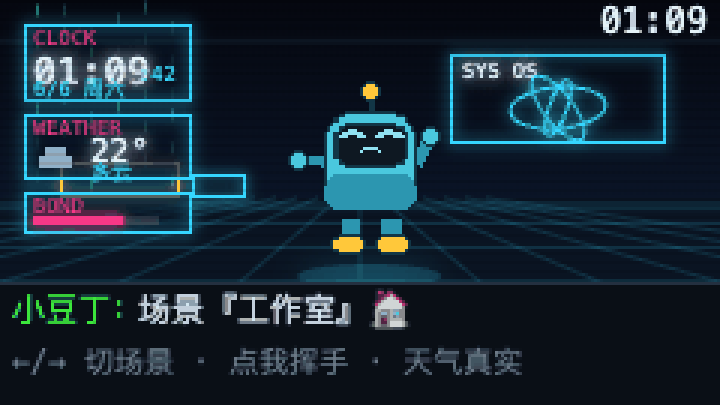

<p dir="auto"><img src="https://raw.githubusercontent.com/huaspirit123/xiaodouding/main/docs/demo.gif" alt="小豆丁 — across 10 scenes" class=" img-fluid img-markdown" /></p>

<p dir="auto"><strong>What it does</strong></p>
<ul>
<li>💬 <strong>Chats with memory</strong> — an LLM brain (DeepSeek by default, any OpenAI-compatible endpoint works) running on your PC; it remembers facts about you across sessions.</li>
<li>🎙️ <strong>Voice</strong> — hold a key to talk (streaming speech-to-text), and it talks back (TTS), all device-direct via DashScope. Push-to-talk up to ~1 minute.</li>
<li>🌆 <strong>A little life</strong> — it roams a "pixel holographic workstation" across <strong>10 day/night scenes</strong> (studio / living room / bedroom / city / desert / grassland / ocean / snow / forest / space), switching indoor scenes by time of day, and reacts to your messages with moods.</li>
<li>⏰ <strong>Real info on screen</strong> — live clock, <strong>real local weather</strong> (open-meteo, auto-located), WiFi signal bars — animated continuously on the ESP32-S3's second core so it never freezes.</li>
</ul>
