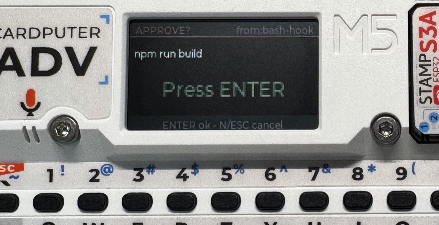

<p dir="auto"><strong>Ordinary action — one Enter:</strong></p>
<p dir="auto"><img src="https://raw.githubusercontent.com/loml13/cardputer-claude-mcp/main/docs/approve.jpg" alt="approve" class=" img-fluid img-markdown" /></p>

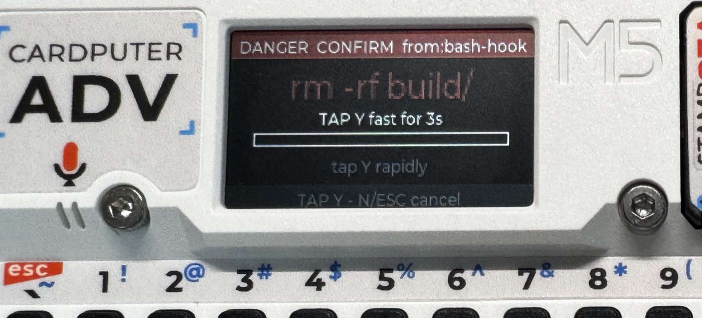

<p dir="auto"><strong>Destructive action — hold Y for ~3s:</strong></p>
<p dir="auto"><img src="https://raw.githubusercontent.com/loml13/cardputer-claude-mcp/main/docs/danger.jpg" alt="danger" class=" img-fluid img-markdown" /></p>

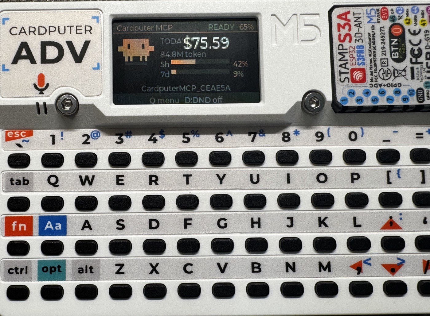

<p dir="auto"><strong>Other bits</strong></p>
<ul>
<li>Always-on usage dashboard: today's spend, 5h/7d subscription utilization, battery %, and a resident pixel-crab<br />
mascot.</li>
<li>notify / ask / confirm tools so the agent can buzz a banner, ask a multiple-choice question, or demand confirmation.</li>
</ul>
