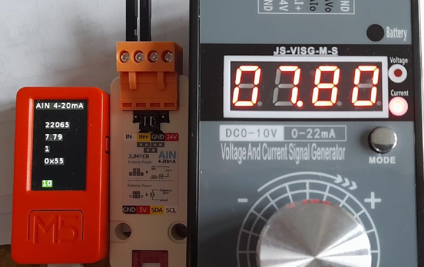

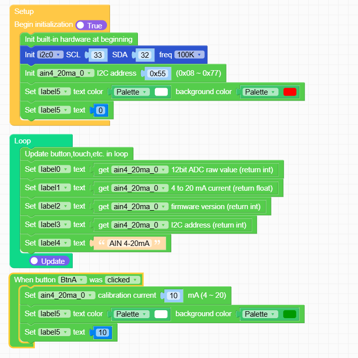

<p dir="auto"><a class="plugin-mentions-user plugin-mentions-a" href="/user/fkarner" aria-label="Profile: fkarner">@<bdi>fkarner</bdi></a> Tak mam podłączone i odczyt wynosi ciągle zero</p>
<p dir="auto">this works for me:</p>
<p dir="auto"><img src="/assets/uploads/files/1742568109667-ain1.png" alt="ain1.PNG" class=" img-fluid img-markdown" /></p>
<p dir="auto"><img src="/assets/uploads/files/1742568216110-ain2.jpg" alt="ain2.jpg" class=" img-fluid img-markdown" /></p>

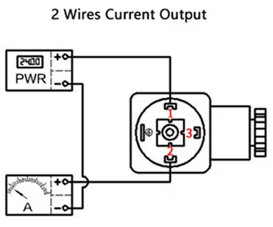

<p dir="auto">From my point of view it should work. Some time ago, I connected the AIN module with a pressure sensor according to this scheme:<br />
<img src="/assets/uploads/files/1741977290832-37643aff-effd-4f5c-85a2-0991437ec624-image.png" alt="37643aff-effd-4f5c-85a2-0991437ec624-image.png" class=" img-fluid img-markdown" /></p>
<p dir="auto">Works well in my case.</p>
<p dir="auto">flori</p>
