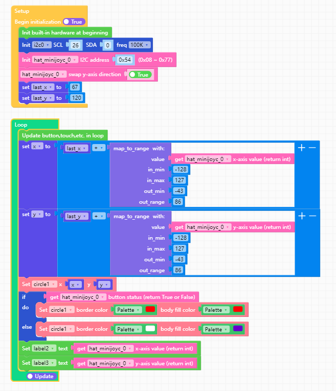

]]></description><link>https://community.m5stack.com/post/26662</link><guid isPermaLink="true">https://community.m5stack.com/post/26662</guid><dc:creator><![CDATA[lbuque]]></dc:creator><pubDate>Wed, 09 Oct 2024 03:01:28 GMT</pubDate></item><item><title><![CDATA[Reply to MiniJoyC support in UIFlow2 on Wed, 09 Oct 2024 01:14:06 GMT]]></title><description><![CDATA[<p dir="auto">I found if you scan the bus before doing any other read or write, things start to work with direct I2C calls, somewhat.</p>

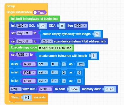

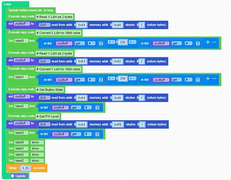

<p dir="auto">I can only get RAW values, reading from memory address 0x10 or 0x20 always return zeros.</p>
<p dir="auto">Also, setting Calibration values doesn't seem to have an effect on the RAW values</p>
<p dir="auto">Here is the code I have working to read RAW values and  FW version as well as set RGB LED colors<br />
<img src="/assets/uploads/files/1728436376210-uiflow1.jpg" alt="UIFlow1.jpg" class=" img-fluid img-markdown" /><br />
<img src="/assets/uploads/files/1728436389791-uiflow2.jpg" alt="UIFlow2.jpg" class=" img-fluid img-markdown" /></p>
<p dir="auto">It would still be nice if the actual library was working as expected</p>

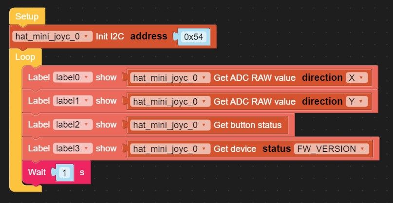

This UIFlow1 code works<br />
<img src="/assets/uploads/files/1728401995183-uiflow1.jpg" alt="UIFlow1.jpg" class=" img-fluid img-markdown" /></p>

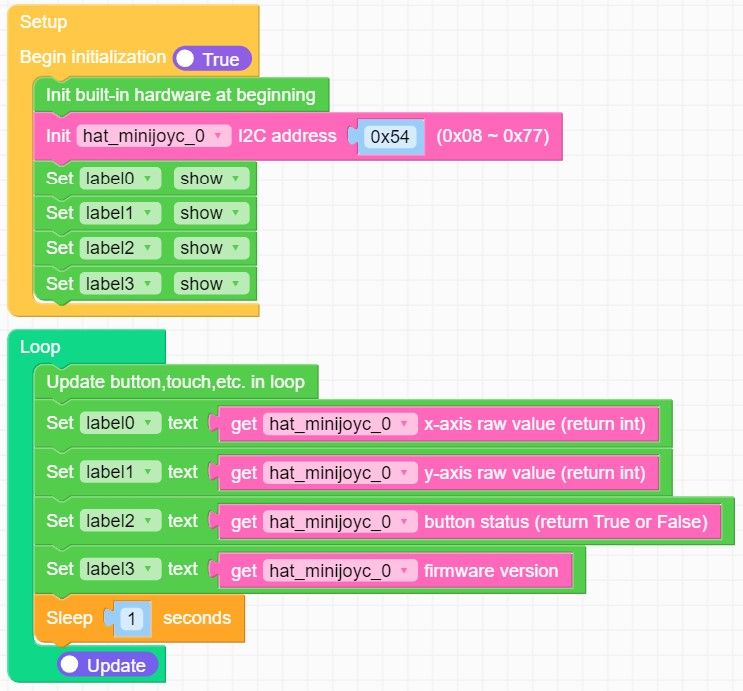

<p dir="auto">This UIFlow2 code does not work. X and Y are 0 and Firmware changes with button push<br />
<img src="/assets/uploads/files/1728402054183-uiflow2.jpg" alt="UIFlow2.jpg" class=" img-fluid img-markdown" /></p>

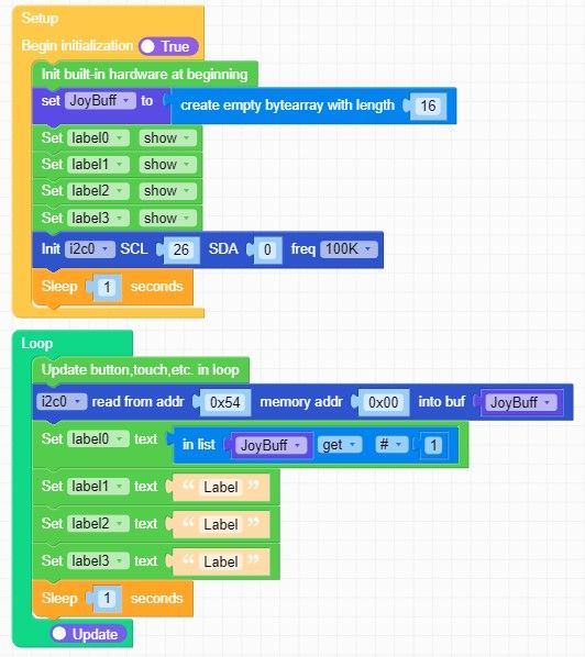

<p dir="auto">I get timeouts when trying to read I2C directly<br />
<img src="/assets/uploads/files/1728402080232-uiflow2-1.jpg" alt="UIFlow2-1.jpg" class=" img-fluid img-markdown" /></p>
