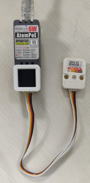

<p dir="auto">In another script, I'm trying to upload 'ENV' sensor readings to AWS IoT Core using MQTT.</p>
<p dir="auto">I've connected AtomPoE Base to AtomS3 for Ethernet, using the port behind AtomS3, and attached the ENV sensor to the Grove port. Both AtomPoE and the ENV sensor use different ports. However, when I use MQTT_Client.connect(), it triggers a similar crash in the ENV sensor. Without the connection, the sensor works perfectly fine.</p>
<p dir="auto">Any advice on how to address this issue would be greatly appreciated!</p>

<p dir="auto">Both sensors use the same Grove connector pins, and since AtomS3 has only one Grove port, I've connected both sensors with Grove-T connectors.</p>
<p dir="auto">If they still don't work together, I'll try connecting one sensor directly to the GPIO port at the back of AtomS3. Any more suggestions are welcome!</p>
