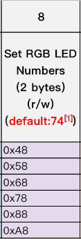

<p dir="auto">if that is really true, e.g. only one RGB LED per port, then the <a href="https://docs.m5stack.com/en/unit/pbhub_1.1" target="_blank" rel="noopener noreferrer nofollow ugc">documentation</a> should be adapted. It still says the default number is 74 indicating it can handle up to 74 RGB LEDs.</p>
<p dir="auto"><img src="/assets/uploads/files/1709316133507-pbhubv1_1_rgb_led_num_20240301.png" alt="0_1709316131973_PbHubv1_1_RGB_LED_Num_20240301.png" class=" img-fluid img-markdown" /></p>
<p dir="auto"><img src="/assets/uploads/files/1709316207810-pbhub1_1rgb_led_max_20240301.png" alt="0_1709316206742_PbHub1_1RGB_LED_max_20240301.png" class=" img-fluid img-markdown" /></p>
<p dir="auto"><a class="plugin-mentions-user plugin-mentions-a" href="/user/m5stack" aria-label="Profile: m5stack">@<bdi>m5stack</bdi></a> : please fix. Thank you.</p>
