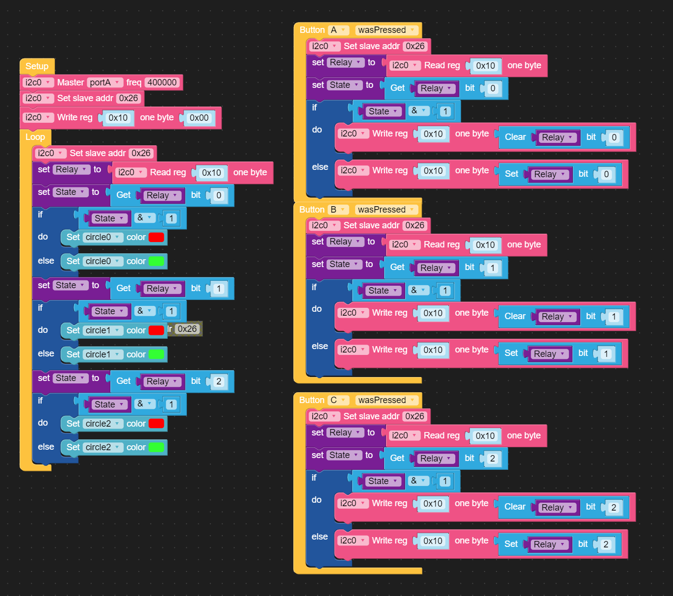

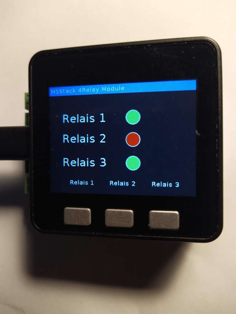

<?xml version="1.0" encoding="UTF-8"?><rss xmlns:dc="http://purl.org/dc/elements/1.1/" xmlns:content="http://purl.org/rss/1.0/modules/content/" xmlns:atom="http://www.w3.org/2005/Atom" version="2.0"><channel><title><![CDATA[4Relay Module UIFlow]]></title><description><![CDATA[<p dir="auto">The M5Stack UIFlow libraries for 2Relay Module or the 4Relay Unit don't work for the 4Relay Module. So you have to use the I2C Master Blocks.</p>
<p dir="auto">Here is an example using the M5Stack Core toggling 3 Relays using the buttons A B C:</p>
<p dir="auto"><img src="/assets/uploads/files/1673535190994-4relay-resized.png" alt="0_1673535165986_4Relay.png" class=" img-fluid img-markdown" /><br />
<img src="/assets/uploads/files/1673535251037-relais4-resized.jpg" alt="0_1673535245682_Relais4.jpg" class=" img-fluid img-markdown" /></p>
<p dir="auto">UiFlow-Code (m5f): [<a href="https://forum.bastelgarage.ch/assets/files/2023-01-12/1673533548-943791-4relay6.zip" target="_blank" rel="noopener noreferrer nofollow ugc">https://forum.bastelgarage.ch/assets/files/2023-01-12/1673533548-943791-4relay6.zip</a>)]</p>

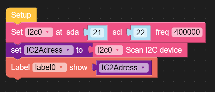

Are you using the "4Relay module" or the "4Relay unit" or the "2Relay module" ?</p>
<p dir="auto">If you still get an error, try to make a simple Uiflow programm scanning the i2c bus with the 4Relay connected:<br />
<img src="/assets/uploads/files/1675006854907-cfe4a152-de11-4d5b-8158-f44191defe28-image.png" alt="0_1675006853542_cfe4a152-de11-4d5b-8158-f44191defe28-image.png" class=" img-fluid img-markdown" /><br />
You should get the number [38, 117] displayed as Label0, 38 is the decimal for 0x26.<br />
If you get 37 you have another firmware than I have (I2C address 0x25).<br />
If you only get [117] your 4Relay module is not connected to the M5Stack core. 117 (0x75) is the I2C address of the battery management chip.</p>
