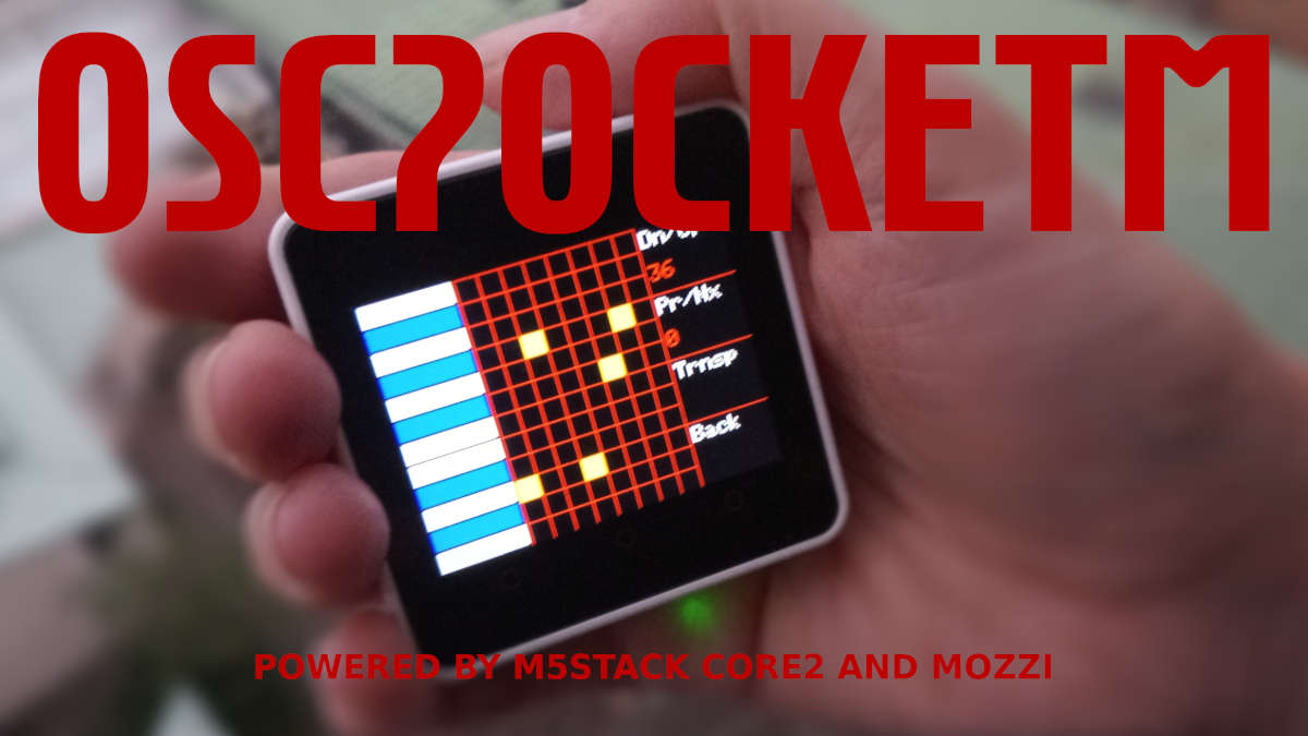

<?xml version="1.0" encoding="UTF-8"?><rss xmlns:dc="http://purl.org/dc/elements/1.1/" xmlns:content="http://purl.org/rss/1.0/modules/content/" xmlns:atom="http://www.w3.org/2005/Atom" version="2.0"><channel><title><![CDATA[OscPocketM - portable beat production tool for the M5Stack Core2]]></title><description><![CDATA[<p dir="auto">Welcome to the OscPocketM (OPM) - the portable beatmaker for the M5Stack Core 2!</p>
<p dir="auto"><img src="/assets/uploads/files/1631992429692-mtitle-resized.jpg" alt="0_1631992428075_mtitle.jpg" class=" img-fluid img-markdown" /><br />
In your hands you will have 3 synthesizers and 1 drum machine that all can be sequenced and used to produce songs.</p>
<p dir="auto">The synthesizers have selectable waveform, a low pass filter that can be modulated, an adjustable envelope and an optional second detunable oscillator.</p>
<p dir="auto">The drum machine has seven sounds: kick, snare, open and closed hihat, clap, tom lo and tom hi. All sounds can be tweaked.</p>
<p dir="auto">All sounds can be balanced using the built in mixer.</p>
<p dir="auto">The synths have a piano roll step sequencer and the drum machine has dedicated 5 track step sequencer.</p>
<p dir="auto">Sequences can be chained using the song editor.</p>
<p dir="auto">There are also utility functions for saving and loading setups and sequences, as well as copying and clearing sequences and settings gate times.</p>
<p dir="auto">All software is running on the Core2 including sound generation using the excellent Mozzi library.</p>
<p dir="auto">Demo: <a href="https://youtu.be/BsVUM46RVbc" target="_blank" rel="noopener noreferrer nofollow ugc">YouTube</a></p>
<p dir="auto">Download: <a href="https://oscillator.se/opensource" target="_blank" rel="noopener noreferrer nofollow ugc">https://oscillator.se/opensource</a></p>
