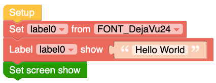

You need to have the "Set Screen Show" block as the information is only stored in memory and not drawn to the screen until set screen show or set screen partial show is called.</p>

<p dir="auto">Everytime I try to upload the code I get warning ' Lack block "Set screen set show" or "Set screen parital show" '</p>
<p dir="auto">Not sure what I am doing wrong, any idea?</p>
<p dir="auto">You need to have one of those blocks in your program to update the screen. They are under UI, then Screen in uiFlow.</p>
