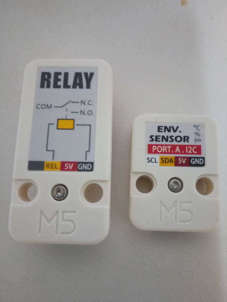

]]></description><link>https://community.m5stack.com/post/10178</link><guid isPermaLink="true">https://community.m5stack.com/post/10178</guid><dc:creator><![CDATA[Kris]]></dc:creator><pubDate>Wed, 23 Sep 2020 09:27:11 GMT</pubDate></item><item><title><![CDATA[Reply to ENV+Relay on Mon, 21 Sep 2020 11:40:03 GMT]]></title><description><![CDATA[<p dir="auto">Check the pin layout of the two units:</p>
<p dir="auto"><img src="/assets/uploads/files/1600688379905-img_20200921_203452-resized.jpg" alt="0_1600688353034_IMG_20200921_203452.jpg" class=" img-fluid img-markdown" /></p>
]]></description><link>https://community.m5stack.com/post/10158</link><guid isPermaLink="true">https://community.m5stack.com/post/10158</guid><dc:creator><![CDATA[liemph]]></dc:creator><pubDate>Mon, 21 Sep 2020 11:40:03 GMT</pubDate></item><item><title><![CDATA[Reply to ENV+Relay on Mon, 21 Sep 2020 11:33:32 GMT]]></title><description><![CDATA[<p dir="auto"><a class="plugin-mentions-user plugin-mentions-a" href="/user/kris" aria-label="Profile: Kris">@<bdi>Kris</bdi></a> The ENV unit uses I2C interface while the Relay unit uses a single bus (simple digital i/o) interface. For example, if you use M5Stack Fire, as default, the ENV unit is connected to Port A (I2C) and the Relay unit to Porb B (I/O). For some reason, if you really need to use Port A for your Relay unit, of course, you can. But you have to carefully program the correct pin of Port A to work as an output port to control the relay. To be more precise, the pin for SDA of (I2C) (yellow color) of Port A should be programmed to be an output pin (corresponding to the REL pin of your Relay unit). For this particular case, the fourth pin (SCL, white color) of the Port A is not used. The same grove cable can be used for both units. Good luck.</p>
