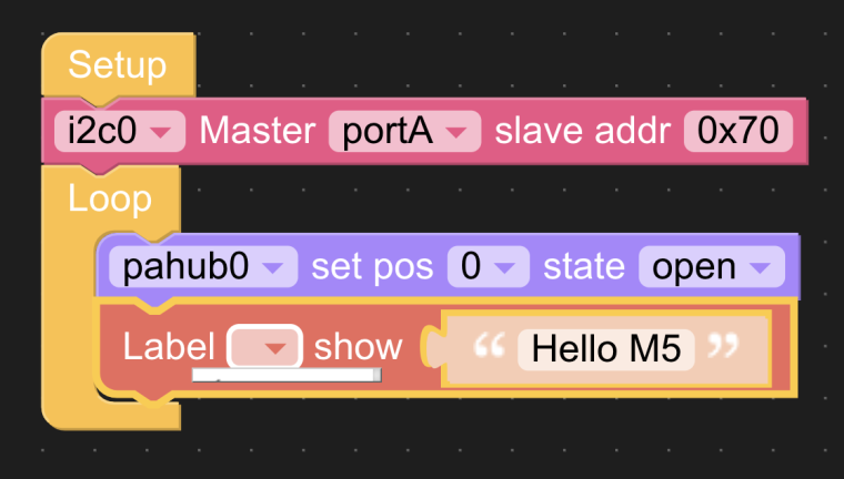

Thank you for your precise explanation!<br />
So I can still use M5Stack's unit cable and PaHub!</p>
<p dir="auto">I checked PaHub code above example here and tried to use UIflow.<br />
<a href="https://docs.m5stack.com/#/en/unit/pahub" target="_blank" rel="noopener noreferrer nofollow ugc">https://docs.m5stack.com/#/en/unit/pahub</a></p>
<p dir="auto">But I can't click the number and can't expect how programming..<br />
Maybe I have to ask other question thread~<br />
Thank you so much!</p>
<p dir="auto">V14.3<br />
<img src="https://www.dropbox.com/s/hjoi56if93ggo31/Screen%20Shot%202020-02-18%20at%203.33.03.png?dl=0" alt="alt text" class=" img-fluid img-markdown" /></p>
